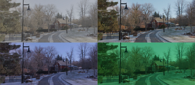

    Exemple de LUTs : Nicest709, Locon cool, Matrix
